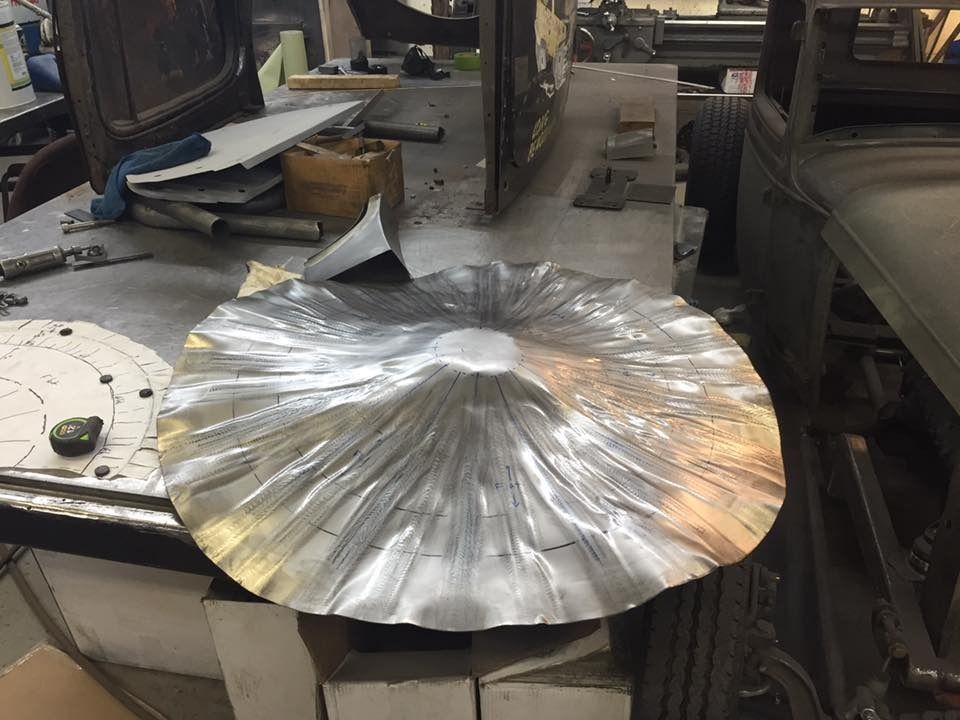

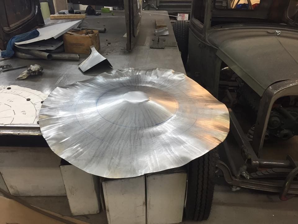

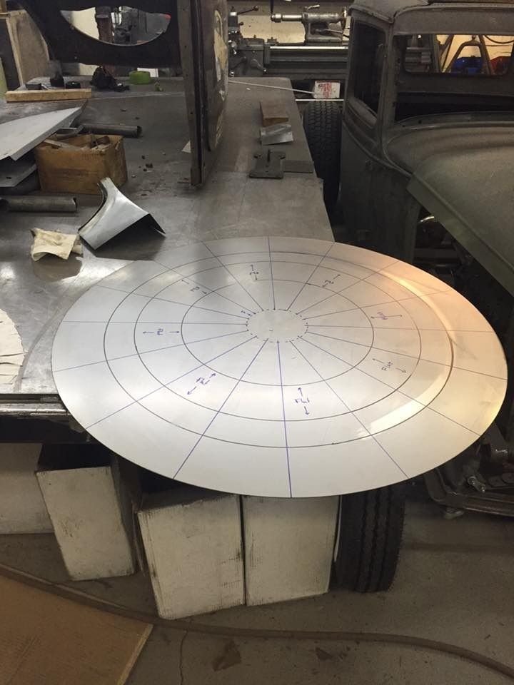

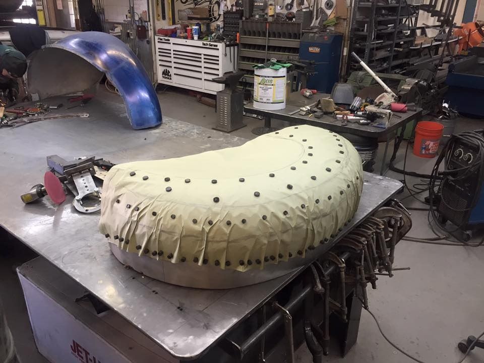

i have been super busy lately and not a lot of time to post much. i have really been working on a lot metal shaping type projects. so this thread will be devoted to just that. thanks for looking

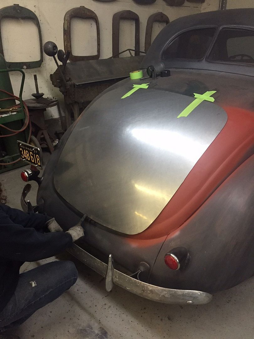

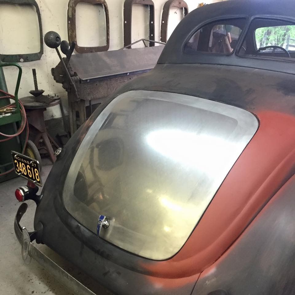

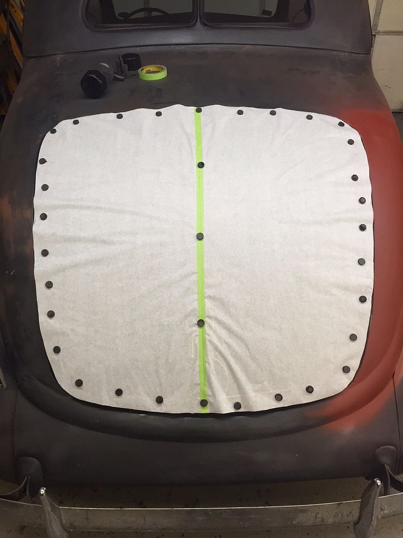

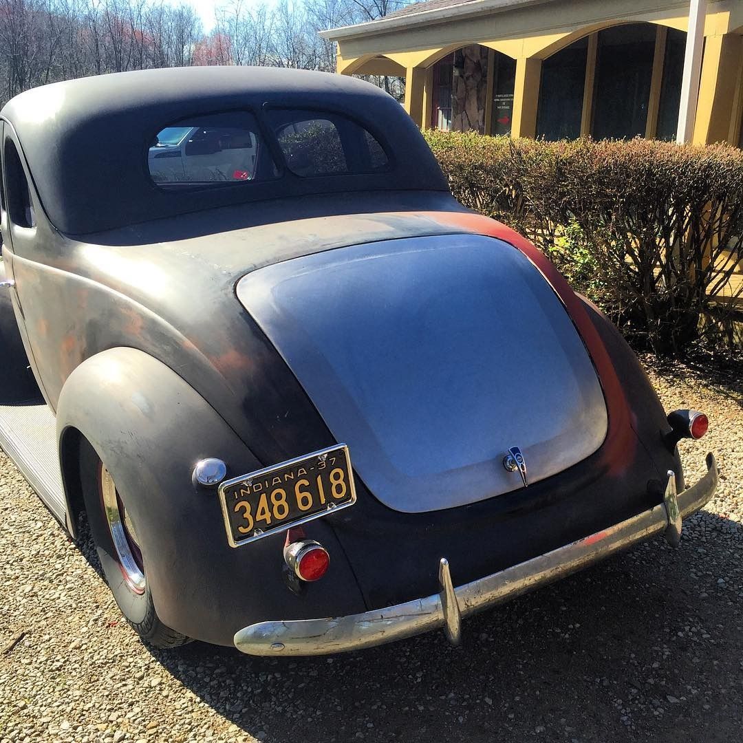

making a 37 ford coupe deck lid skin

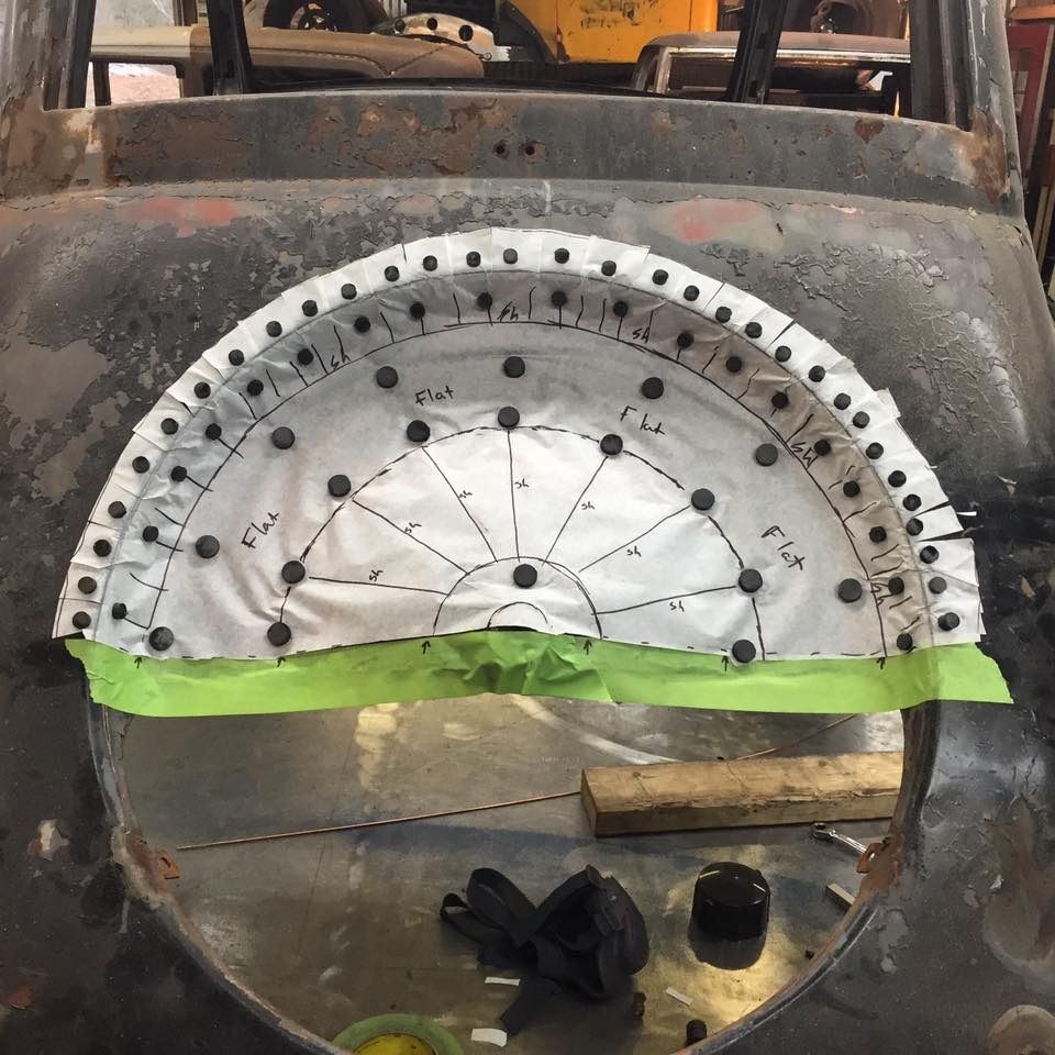

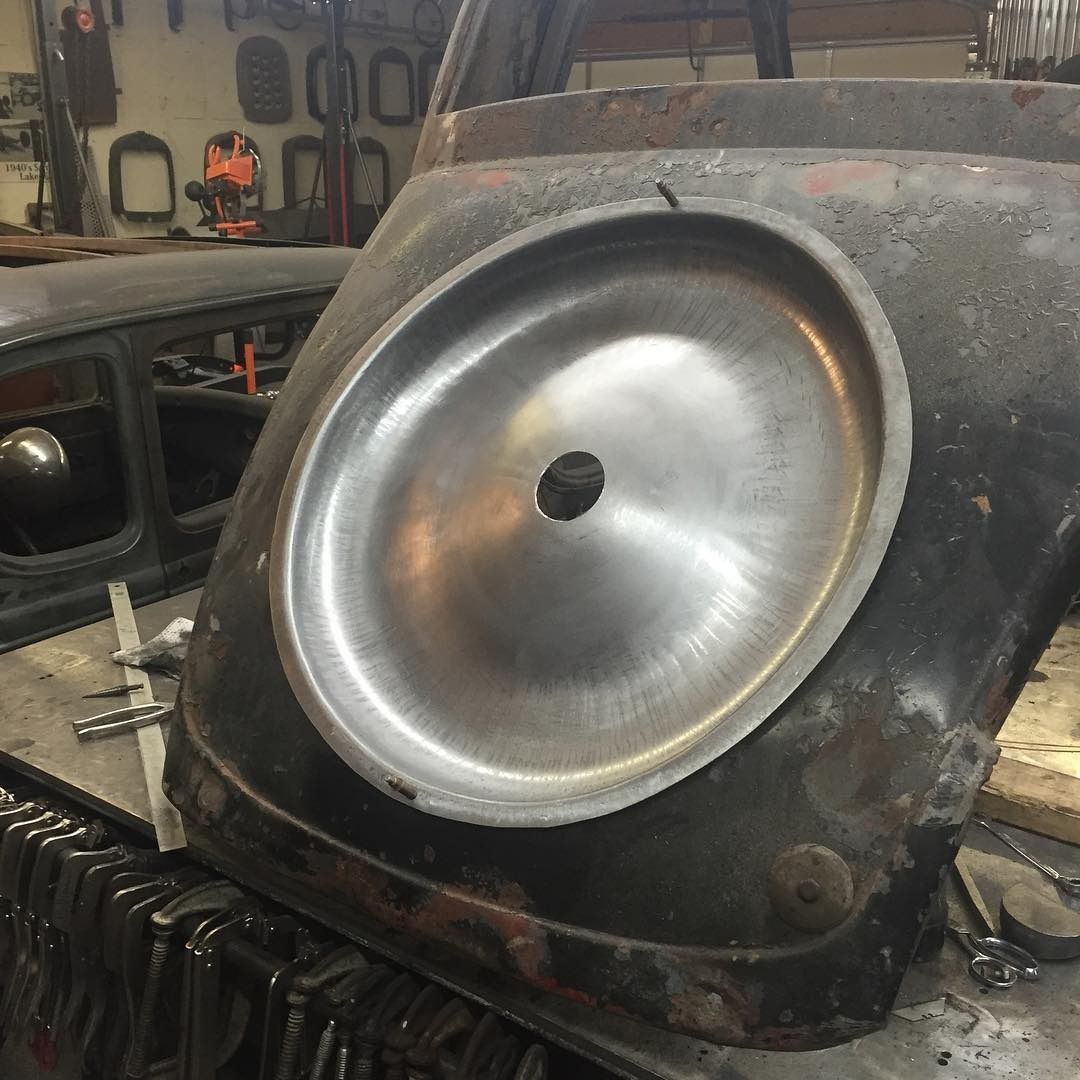

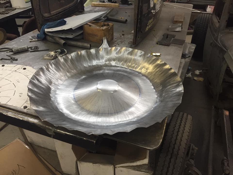

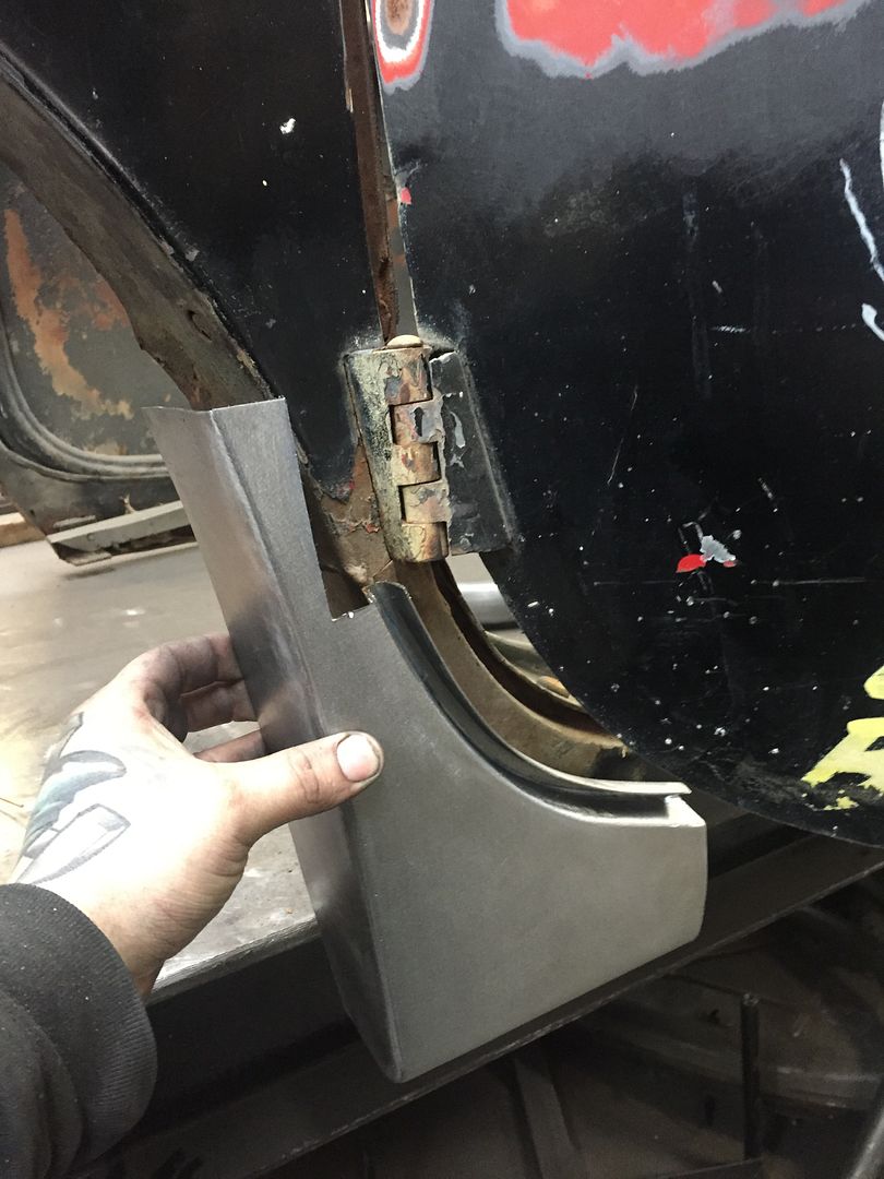

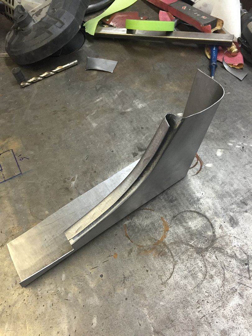

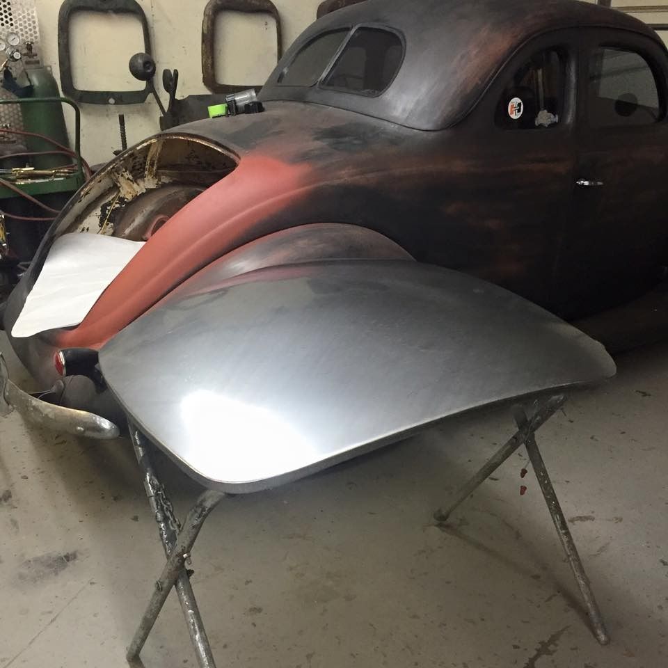

recent sheet metal repairs on a Fiat Topolino

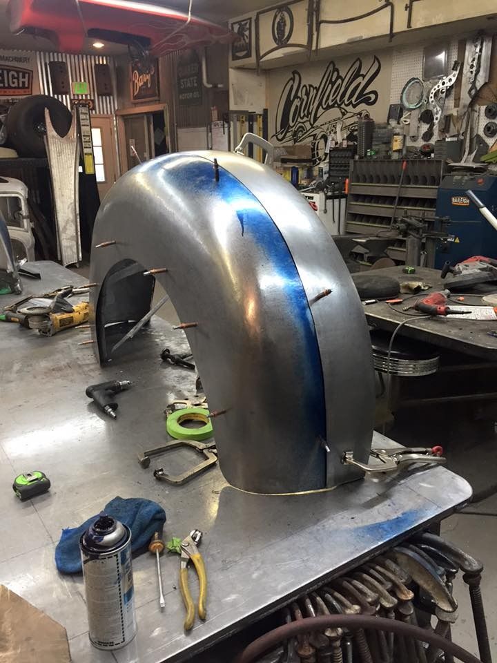

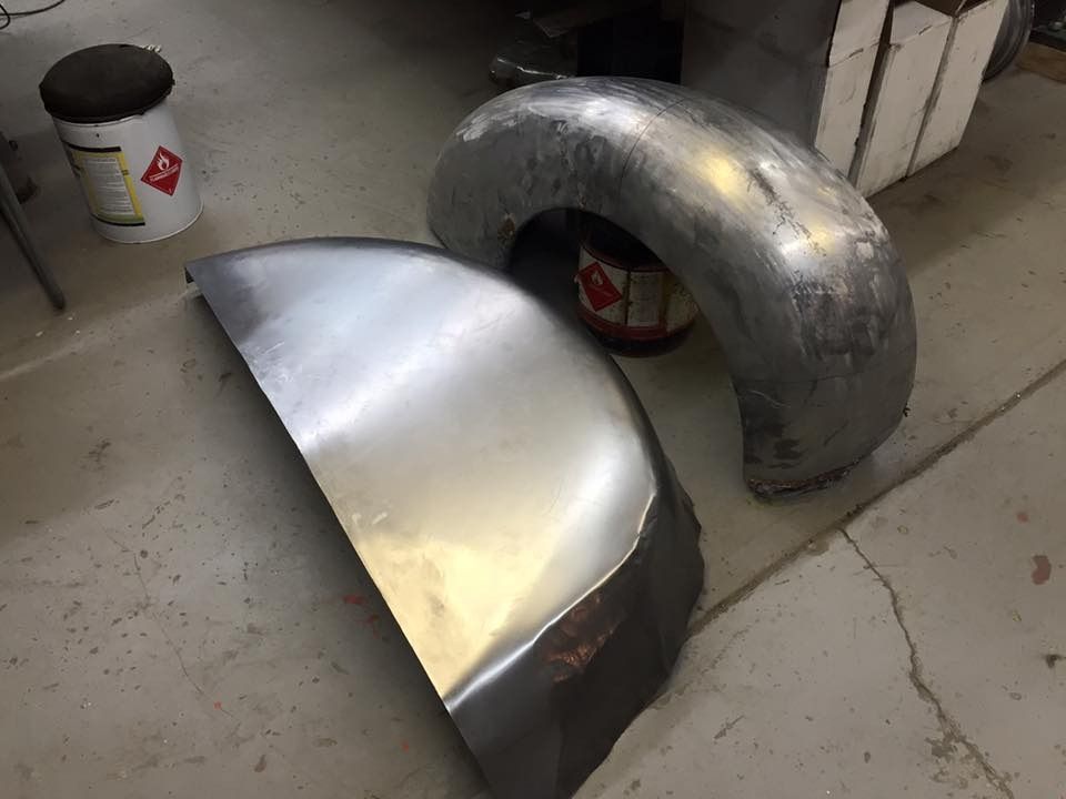

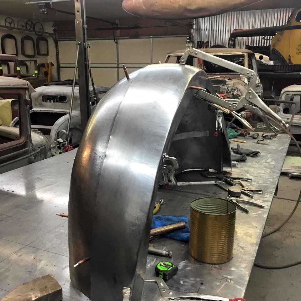

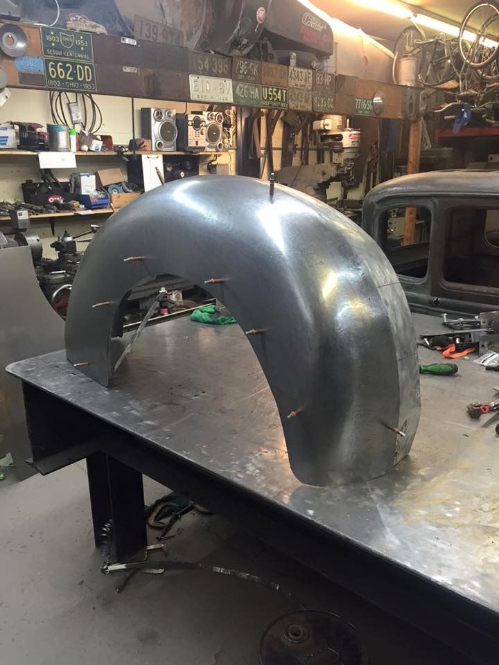

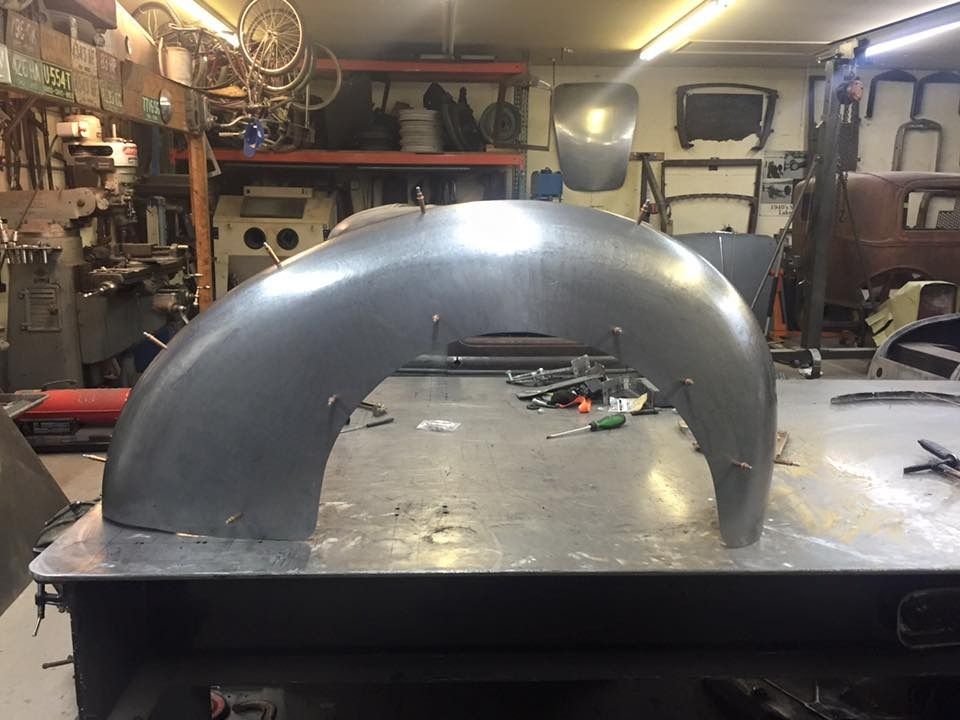

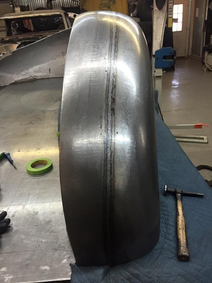

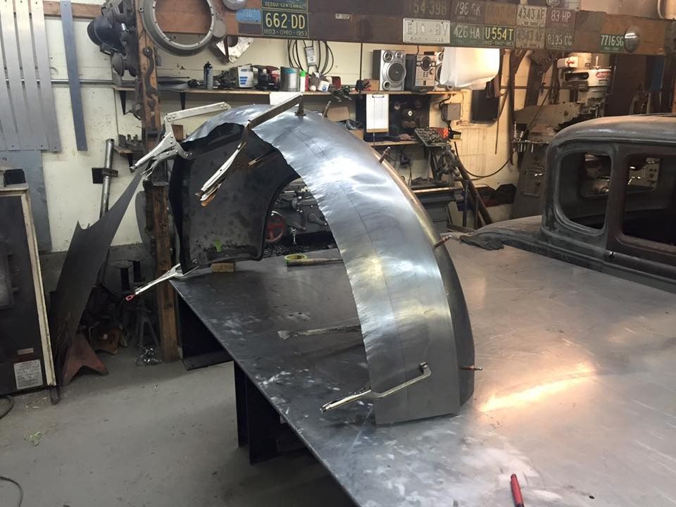

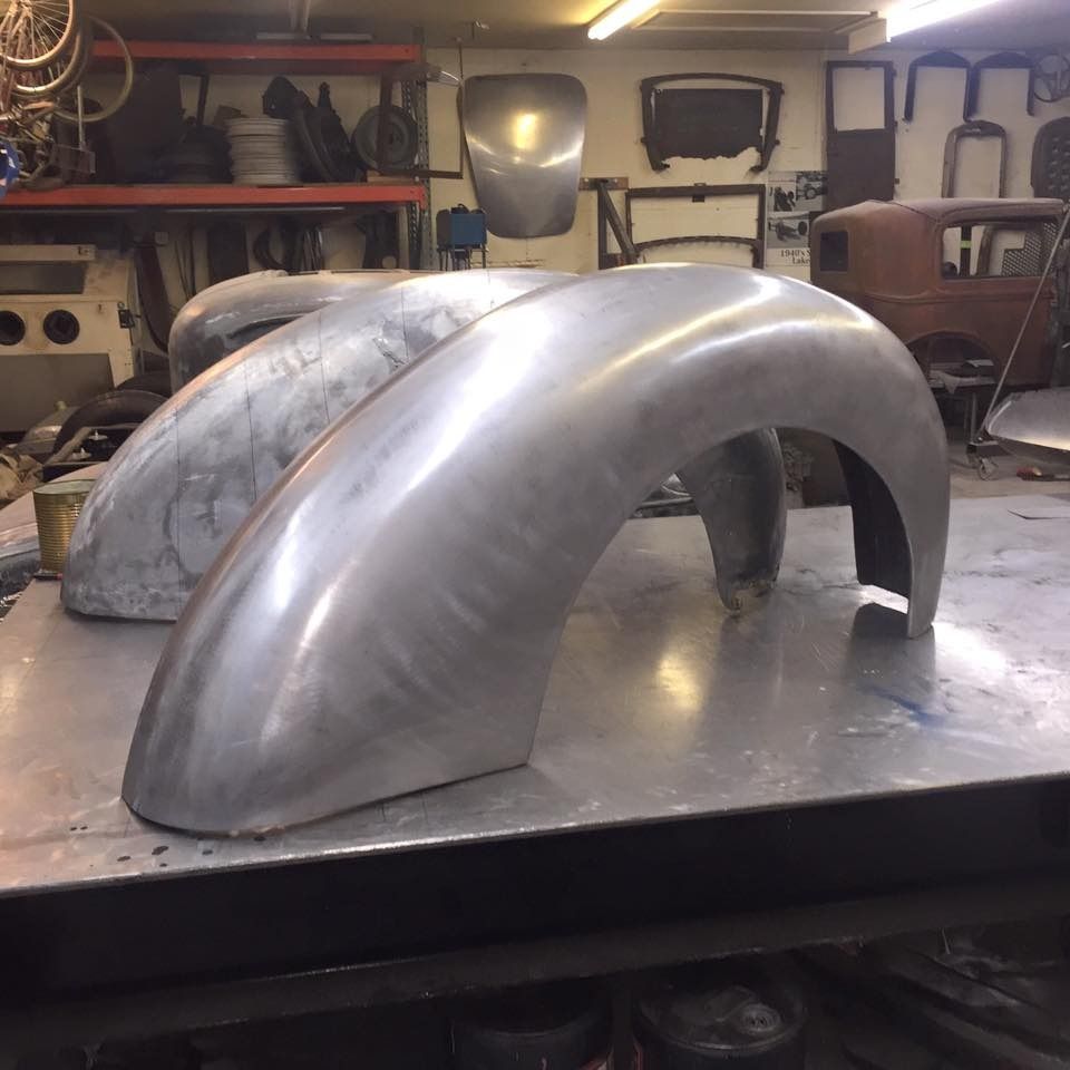

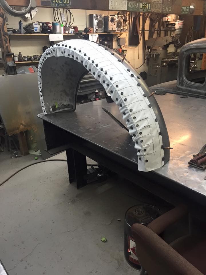

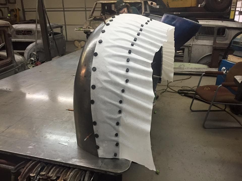

had to make a new rear fender for a customers 46 chevy truck. made in 2 pieces

That spare tire pan is impressive.

metal does not give up it's flat shape easily.
good job!
I agree. How are you making tucks that far from the edge?
There are two things in life where penetration is really important .....and one of them is welding.
My 48 chevy flatbed http://ratrodsrule.com/forum/showthread.php?t=604
The Roofus Special http://ratrodsrule.com/forum/showthr...ghlight=roofus
Old 04-17-2016, 09:50 PM
cornfield customs's Avatar
cornfield customs cornfield customs is offline
Join Date: Mar 2008
Location: Loveland OH
Posts: 1,027
power hammer
