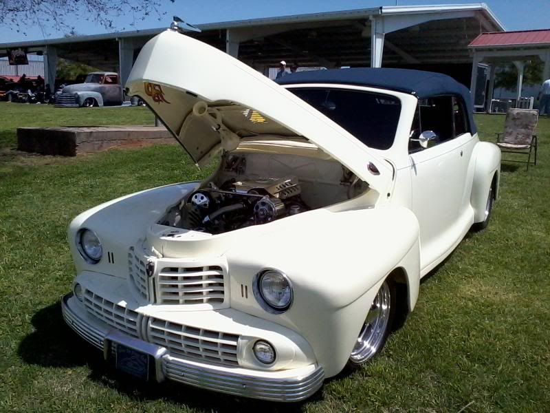

Hey, that's David Brown's Linc! We've been talking over on the HAMB. No way I'll ever get into chopping mine like that, too much work! Mine will be mostly stock outside, with a few doo dads shaved off.

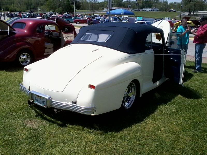

I saw this one this weekend. They changed headlights, taillights, and bumpers...and painted the grill body color. I thought it was an improvement over stock.
