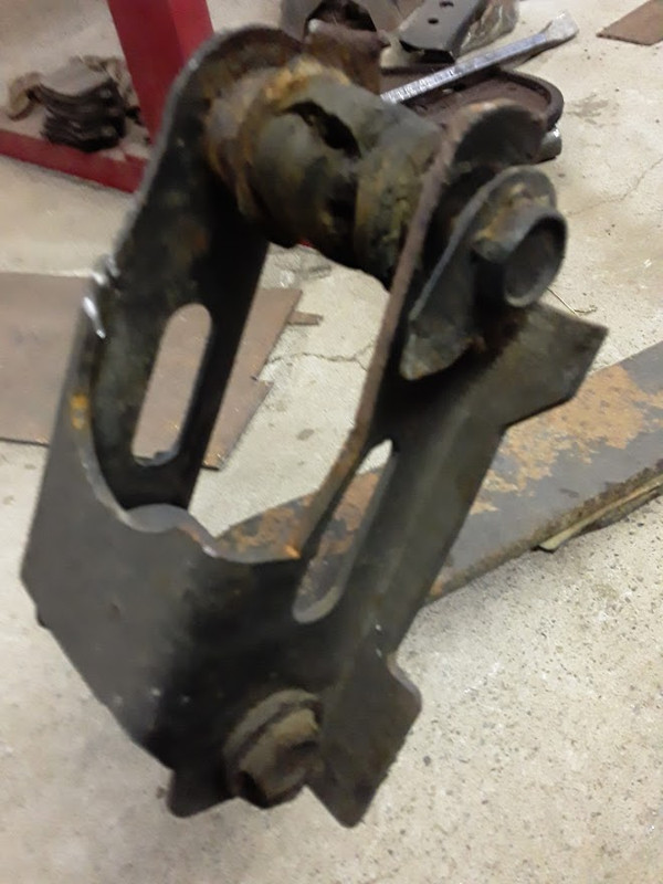

I was trying so hard to get more Mopar into this old heap but it was working out...I had bought a 1985 Monte Carlo rear end a couple months ago...it was a little too narrow so I went on the search for a Mopar rear end to balance things out...found a 1975 Plymouth Road Runner but it had sat outside for so long the backing plates were rotten and I could not find a pair to swap out...oh well...never knew much about Mopar's so back to the Monte Carlo rear end...
I had found a company out of Oregon selling 4 bar kits...I was gonna try and do a Tommy Ring one from scratch but my brain couldn't wrap it self around it...I found the kit and came with all the parts I needed to fit a 1928 to 1945 Mopar...darn thing is made in China...
Something about a pre-war coupe up on jack stands that makes me smile...reminds me of the Fridays I spent at the local oval track watching the crews working on their cars...
Here is the rear shackles they cut to fit the car...nice work for sure...
