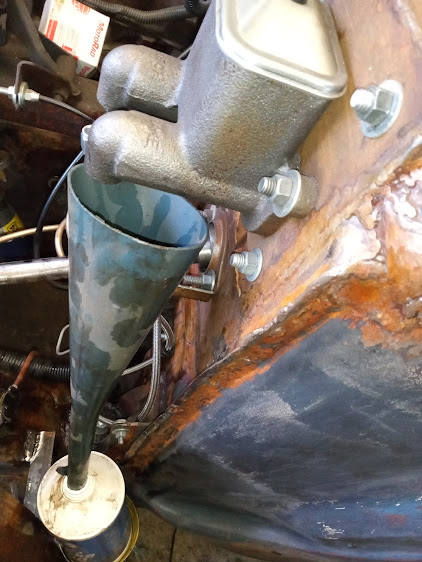

I have learned that when MIG welding while laying on your back...if there is a newly run brake line you will have the welder pop and bang...whatya got???
Damn damn damn...thank GOD for tubing cutters...
I have been fighting with fittings that don't fit...
It took two (2) separate orders from Speedway Motors before we got the right ones...
So the one on the left I thought would fit like the brake line on the left...
They would tighten to a point and then spin...I finally figured it out but what pain in the backside...
