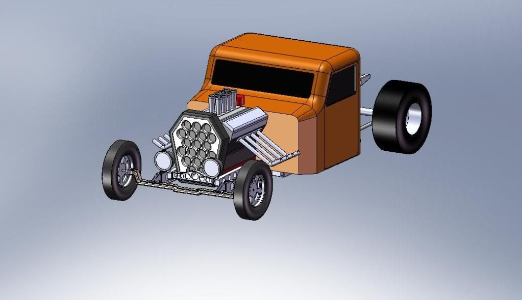

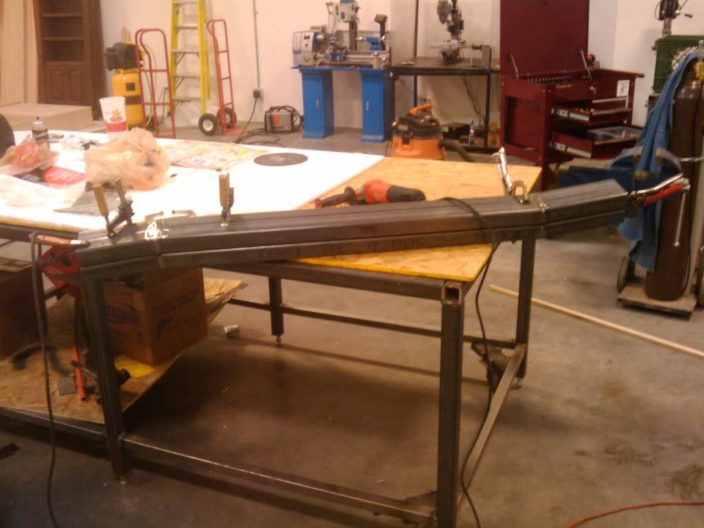

I started designing the truck in Solidworks. I came up with something like this:

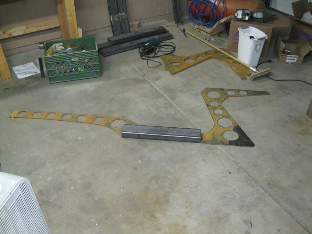

The exposed parts of the frame are water jetted, and the part on which the cab sits is just regular 2x4 tubing. I sent the CAD filed to the water jetter and began fabricating the 2x4 section of the frame.

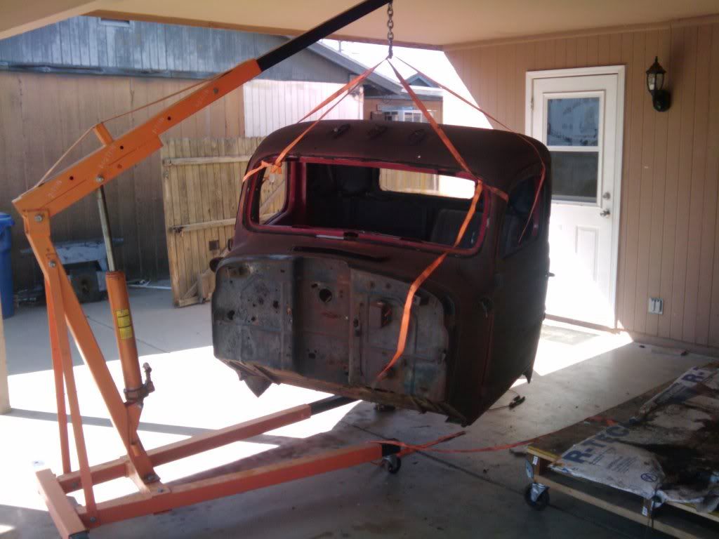

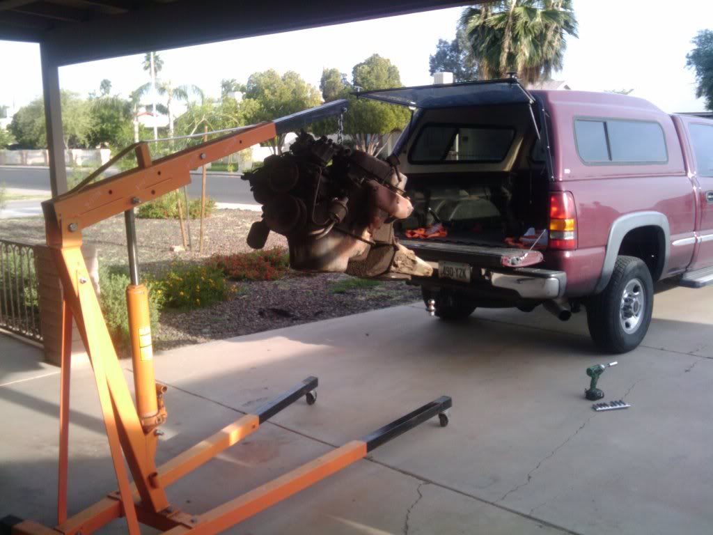

In the mean while, I picked up another Caddy engine. It's a 1970 Cadillac 500 with the transmission that I picked up for $150. It'll need some refreshing, but it was cheaper than even a core.
The engine made my cherry picker cry:
My other engine in the back ground. It's a 1973 Cadillac 500 that I got in trade for a few hours of aluminum welding.
I also moved the cab around, for fun, LOL.

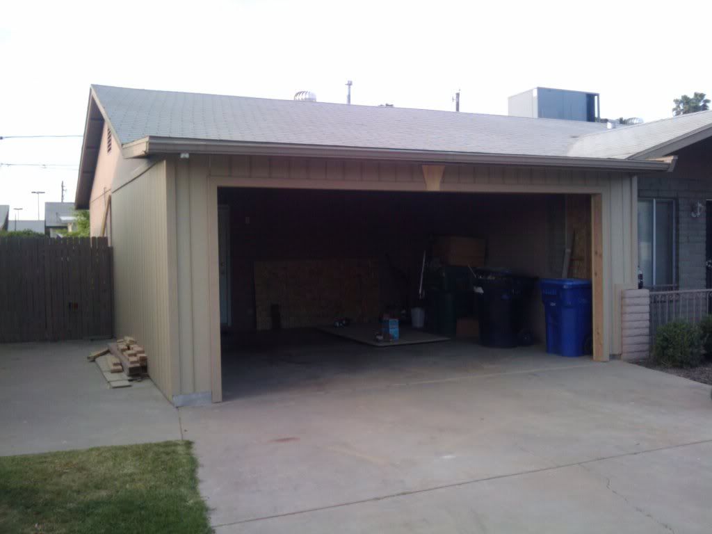

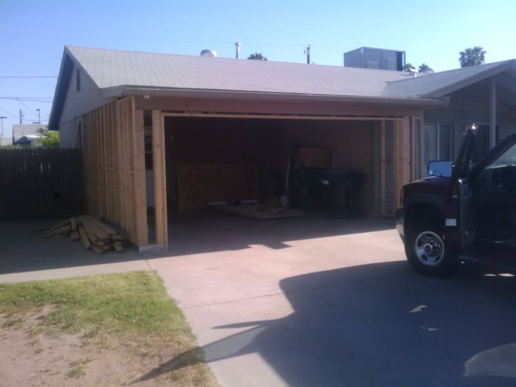

I got the parts from the water jetter a few weeks ago, but it got so hot that I had to do something to improve my working conditions. My house didn't have a garage. It only had a carport, so I decided to buy some lumber and build a garage.

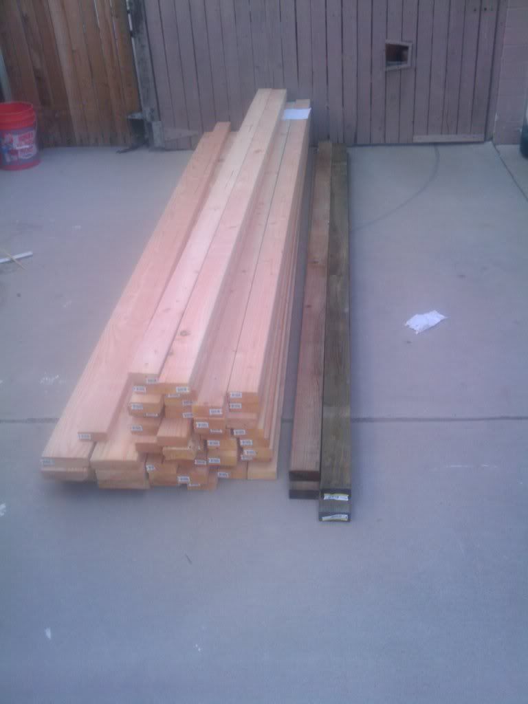

Picked up some lumber:

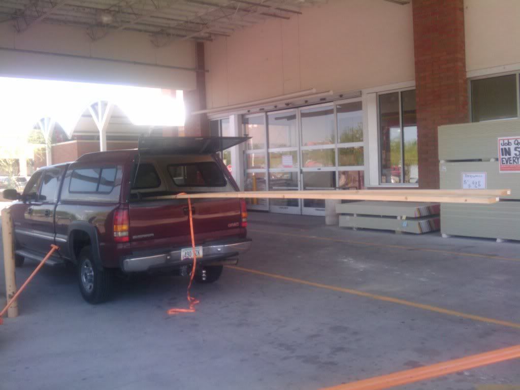

I bought some 20 footer 2x6's and brought them home like this:
Framed the carport:

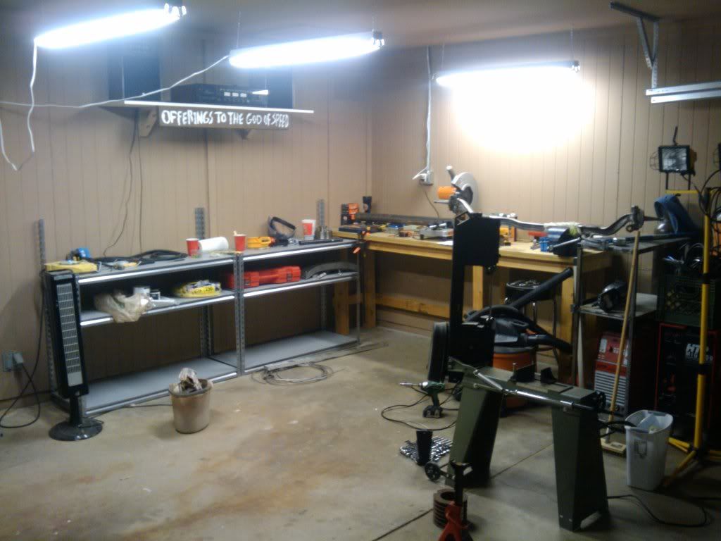

I set up my work space and stereo. It is very important to listen to your favorite tunes when you're working on your rod.

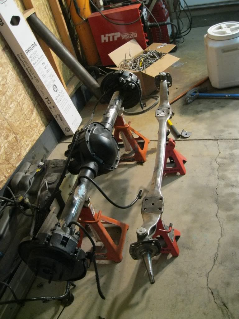

I rebuilt my front king pins:
Then I cut all the brackets from the rear axle (31 spline Ford 8.8") to get it ready for 4-link:
You can kind of see how the frame will end up looking like:

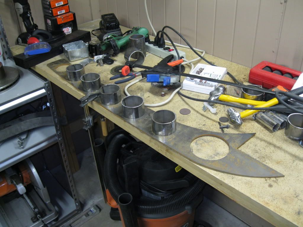

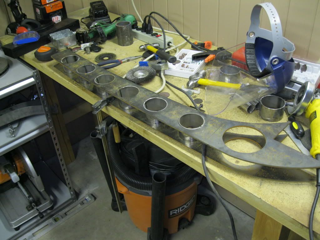

I cut up some tubing for the "lightening holes":

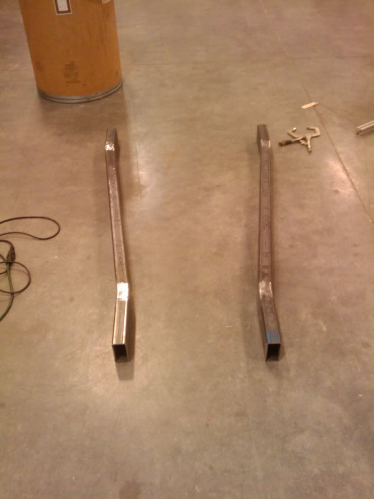

I also had time to mock up the front frame rails tonight:
