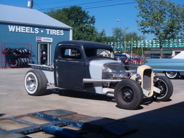

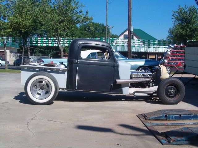

I am starting a new build for my brother , it is a project that was started by someone else who did an excellent job but never finished the project . The truck was loosley assembled , just enough to push it onto the trailer for the trip home . My brother bought it the way it is in the photos , chopped with the magority of the body work finished . The main problem is with the chop and channel that it has he's very uncomfortable in the cab. The bed is a little short for his taste so we plan to lengthen the bed and extend the firewall just a bit to help on the lack of leg room . This will also involve stretching the frame , I think the end result will be worth the extra work .

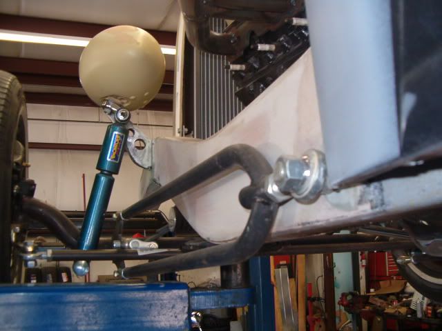

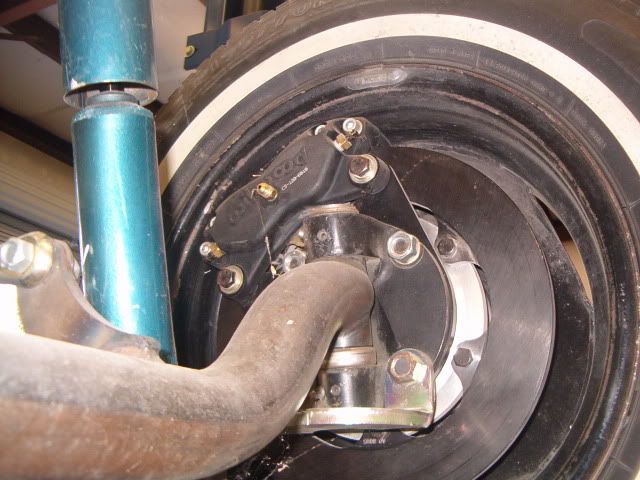

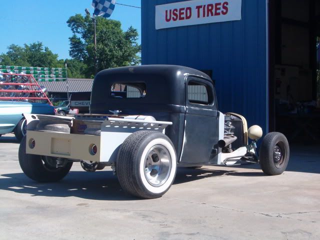

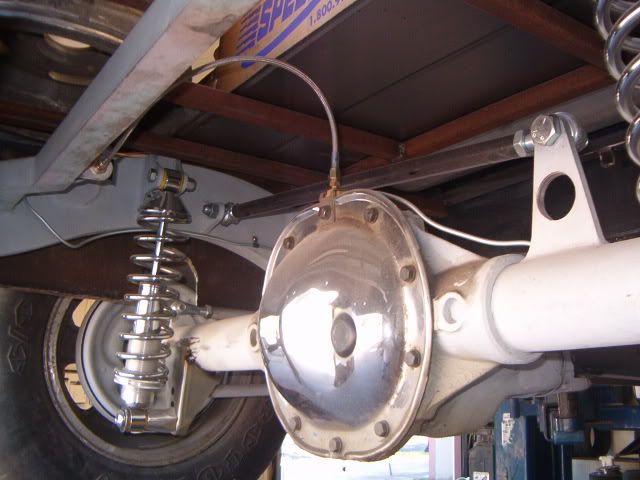

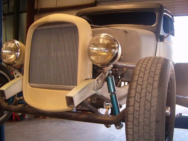

The truck came with a ton of quality parts , some installed some not . here are some reference shots I took before taking it apart .

looks like the fabrication was well done for sure... always a good thing therefore you wont have to rebuild everything...
Its a good looking truck.. but if it were mine i would have to lower the back of the cab.. i perfer them sitting flat... but hey who cares what i think!

That is for sure, the rear shocks are at the end of their adjustments ( soft side ) I will change the position of the upper shock mounts to lower the rear of the truck and put some adjustability into it . I like your way of thinking

That's a handsome looking truck, I really dig it! The chassis fab looks top-notch and it's really nice to see some rails with curves.
If you're going to build a longer bed anyway, how about making it a bit taller? I think it might look better with the top closer to even with the character line on the cab.

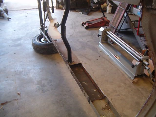

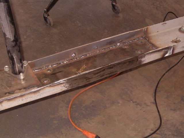

We stripped the truck down clean less the suspension to lengthen the shortened frame . We have decided to lengthen the bed from 38" to 48" and we are also going to extend the cowl of the cab 6" . Adding the 6" and half of the 10" bed extension I will lengthen the frame 11" to keep the same proportions. The total wheel base will be 122" , should give a good look and a great ride . After all the measuring and cross measuring and measuring again and again I finaly made the move and cut the frame into , whew! That first cut into a perfectly good frame is always tough . I made my frame pieces out of 8 guage for the splice doing inner and outer layers with an overlap on the inside for good stength . After getting the frame put together with rosett welds I found it a whole lot easier to stand the frame on it's side to finish weld everything .
